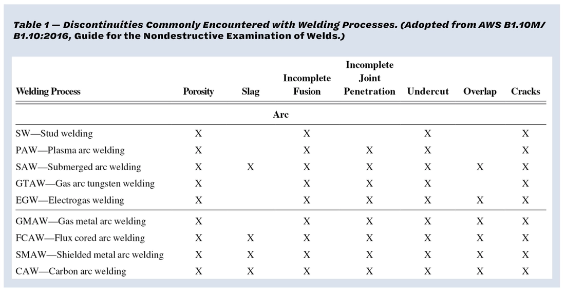

Each welding process comes with its own unique challenges and flaw characteristics — Table 1. Understanding what type of discontinuities to expect from the welders helps to prevent them. Similarly, when the NDE technician understands the types of discontinuities typically found, their interpretations become more accurate. Welding process, joint configuration, weld location, and type and size of weld all help to determine the type of discontinuities to expect and the best method for their detection.

When welding with a flux-containing process, such as shielded metal arc welding or flux cored arc welding, slag is created. When the welder understands the importance of cleaning between the weld beads, they are more likely to take the extra time to remove the slag prior to depositing the next pass. When welding with gas tungsten arc welding (GTAW), we would not expect to find slag but tungsten inclusions and crater cracks.
The welders’ understanding of the importance of adhering to the welding procedure specification (WPS) preheat and interpass temperature requirements helps prevent hydrogen cracking. The cleanliness of the weld joint and the proper storage and handling of the filler materials also help prevent hydrogen cracking.

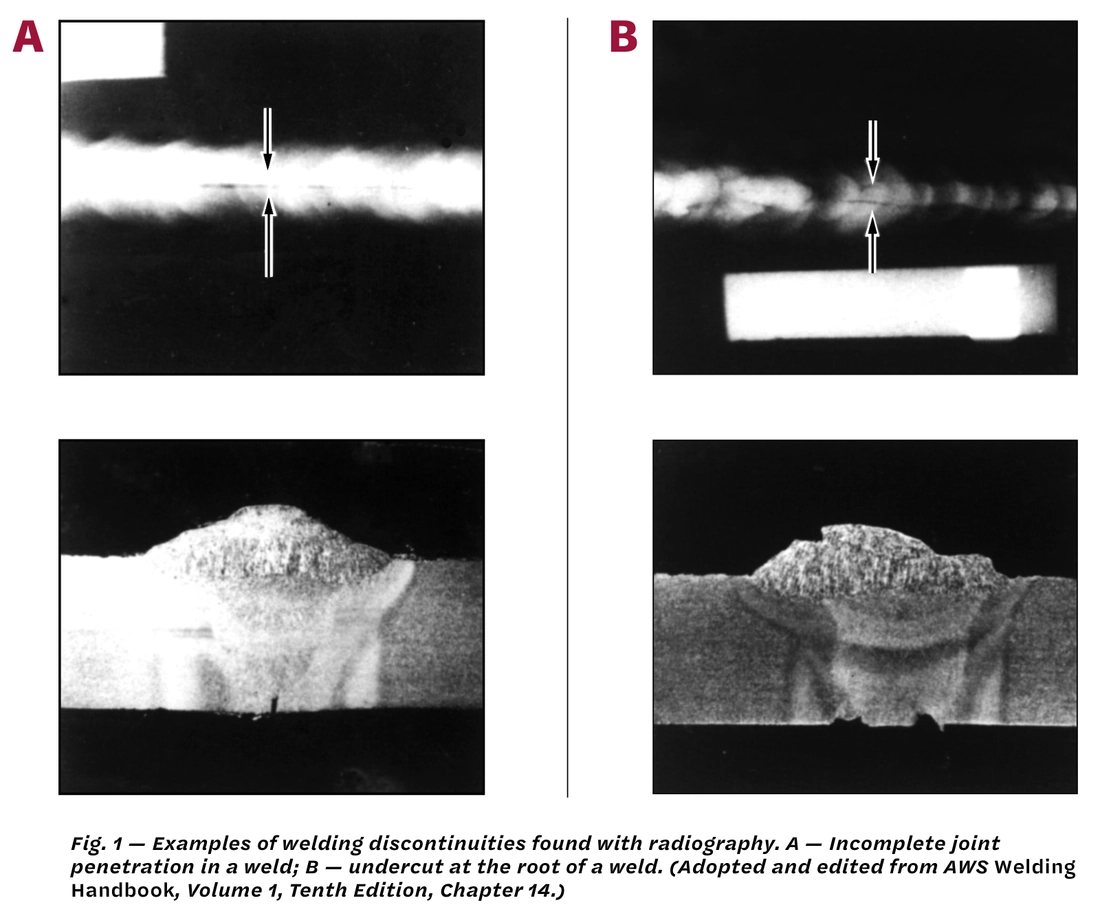

Within ASME B31.3-2024, the primary table of interpretation is Table 341.3.2-1, Acceptance Criteria for Welds – Visual and Radiographic Examination. This table requires an understanding of a flaw type and is assessed based on the size of the flaw. Where specified, UT interpretation is described in paragraph 344.6.2 and Appendix R, Use of Alternative Ultrasonic Acceptance Criteria, for materials over 1 in. In 344.6.2, the flaw type is only categorized as linear or nonlinear. In Appendix R, fracture mechanics applies, and the flaws need not be categorized. In both cases for UT, the flaw type does not matter. Any indications found that exceed the described thresholds are grounds for failure. However, this is a disservice to construction. As mentioned above, flaws specific to each welding type are caused by different issues in the welding processes. PAUT is fully capable of determining flaw types based on echo dynamic characteristics. The position in the weld volume of these flaws can assist in pinpointing the issue — Fig. 1.

It is essential to sit down with the welders after a reject and explain the position, morphology, and possible causes of specific flaws. Often, a welder will look at RT films or a PAUT scan and recall changing conditions or unfavorable fitups in the area where a rejection occurred.
Without this feedback loop and open dialogue, poor-quality welds continue without answers about why they are happening. Even before the examination occurs, it is critical for the NDE inspectors to know what welding processes were used during the weld.
