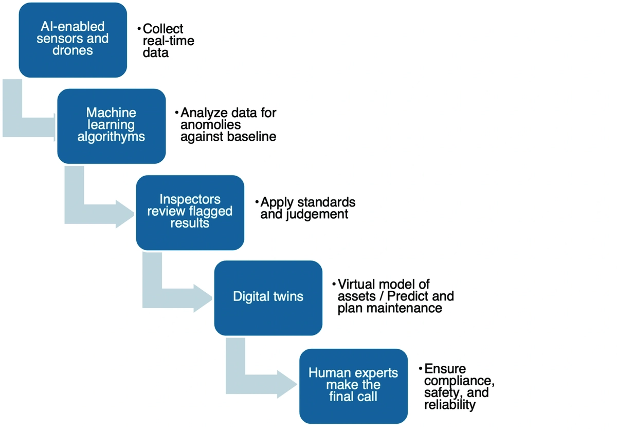

Soon, we can imagine a seamless collaboration between humans and intelligent systems. A possible workflow is illustrated in Fig. 1.
Fig. 1 — AI inspector flow diagram.
In this model, the inspector isn’t just a technician. The inspector becomes the decision-maker, a risk manager, a data interpreter. The work becomes more analytical, less repetitive, and ultimately more impactful. The inspector’s role evolves from finding flaws to ensuring integrity. This partnership is already visible in industries ranging from aerospace to energy. AI systems are already assisting inspectors in visual inspections, corrosion mapping, pipeline integrity testing, and tank farm leak detection and mitigation. Yet even the most advanced models require continuous validation and oversight. When an algorithm flags a potential defect, it’s the certified inspector — trained and certified under standards such as AWS QC1, Specification for AWS Certification of Welding Inspectors, or ASNT Recommended Practice SNT-TC-1A, Personnel Qualification and Certification in Nondestructive Testing — who confirms the finding, interprets its significance, and signs the report.
