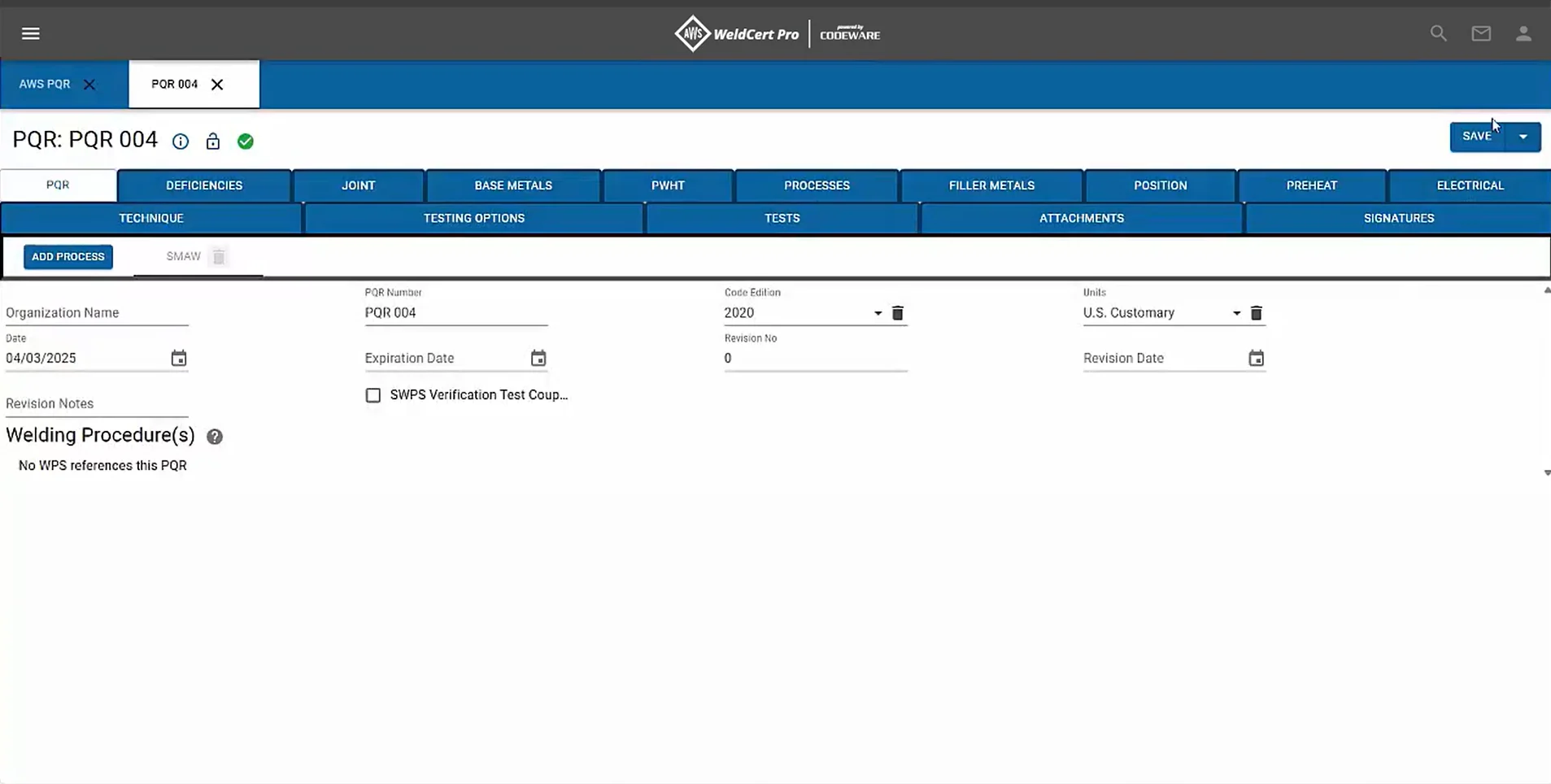

What is AWS WeldCert Pro?
Built in collaboration with Codeware, AWS WeldCert Pro is our new digital platform that will simplify paperwork, reduce errors, and make it easier to stay compliant with QC47: Specification for the Certification of Welders and Accreditation of Test Facilities. Whether you are in the shop, in the field, or at your desk, WeldCert Pro gives you a faster, more reliable way to manage welder qualification testing and certification.
Learn more with the WeldCert Pro Webinar or review the WeldCert Pro Video Recource page

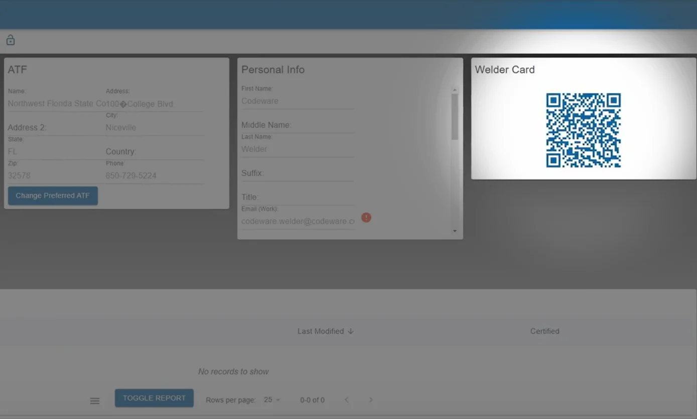

100% Digital Credentials
View credentials anytime, anywhere, from any device—no more lost or damaged wallet cards. Credentials are easily accessed via QR code.

PLATFORM CAPABILITIES
Digital-Only Credentials and QR Code Access
AWS WeldCert Pro introduces 100% digital credentials—offering a secure, modern alternative to physical cards. Each credential features a unique QR code for instant verification by inspectors, employers, and project managers.
Simplified Subscription, Smarter Certification
With AWS WeldCert Pro, welders no longer pay per application. Instead, a single annual subscription of $105 covers everything—unlimited submissions, access to the online continuity log, and powerful digital credentialing tools.
For comparison, a welder who previously submitted two paper applications at $35 each paid $70 annually—with none of the added benefits. Now, for just a bit more, you get automation, reminders, and peace of mind.
And with WeldCert Pro, late renewals are a thing of the past. Welders must maintain continuity to avoid retesting, and the system helps you stay on track with automated reminders—no late fees, no surprises, just a clear path to keeping your certification active.
