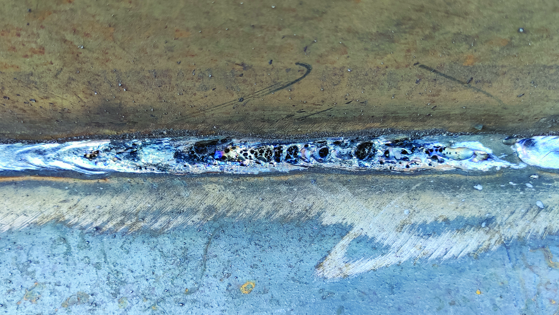

Liners are an essential component of the welding process, and investing in a higher-quality liner will help produce better results. A quality liner is manufactured with higher-end materials and is consistently checked to ensure it meets key specifications. Inconsistencies and deviations can impact how smoothly the wire passes through the torch and accelerate the rate at which the liner wears out. Low-quality liners, although typically cheaper, tend to create more wire drag, which will hinder feeding performance, consumable life, and overall weld quality
WD Oct 24 - Feature 01-Monk-Bernard - Bernard 2.tif
Fig. 2 — Low-quality consumables can increase the likelihood of weld issues, such as porosity and incomplete fusion.
Because the liner is so integral to the welding process, many times an issue with the weld can be traced back to the liner or its setup. If you’re constantly experiencing poor wire feeding, bird-nesting, erratic arcs, or burnbacks, troubleshooting whether the liner is cut to the correct length is a good first step. If the liner is too long or short, it will diminish weld quality.
