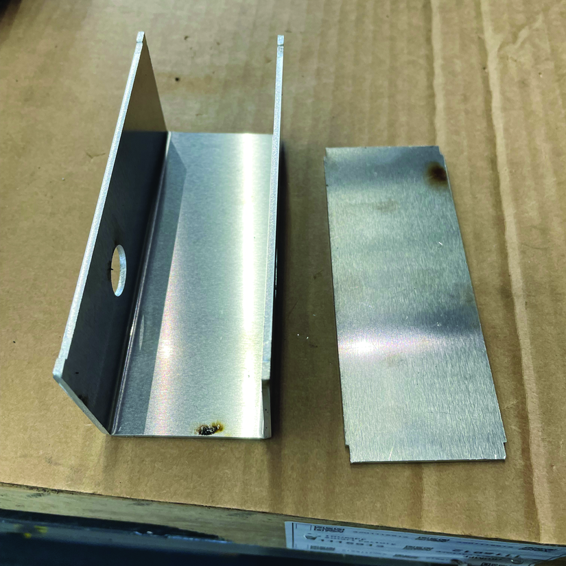

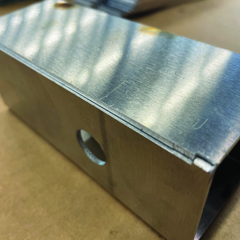

The incorporation of innovative tab and slot designs in part production significantly streamlines the manufacturing process, especially when coupled with effective fixturing. Redesigned components, resembling the popular interlocking mechanism of building blocks, now snap into place like puzzle pieces, simplifying the assembly of parts onto fixtures.
In the pursuit of precision and seamless assembly, TRUMPF Inc. uses a simple design practice when integrating tabs and slots into parts. The choice increases the slot size by 0.12 mm (0.0047 in.) all around and ensures the smooth insertion of tabs, compensating for any potential discrepancies in sheet thickness. To deal with overlapping outside edges, we reduce the tab length size to 80% of the material thickness. This intentional adjustment ensures that the welds on outer corners meld seamlessly, resulting in a refined and visually appealing finish free from unsightly protrusions or irregularities. By implementing these design considerations, you create an easier assembly for operators. Reducing the time between runs when loading fixtures results in more parts being welded daily.

Figs. 2, 3 — A 5-series aluminum tube is made from sheet metal and uses tabs to self-fixture the top plate to the body.

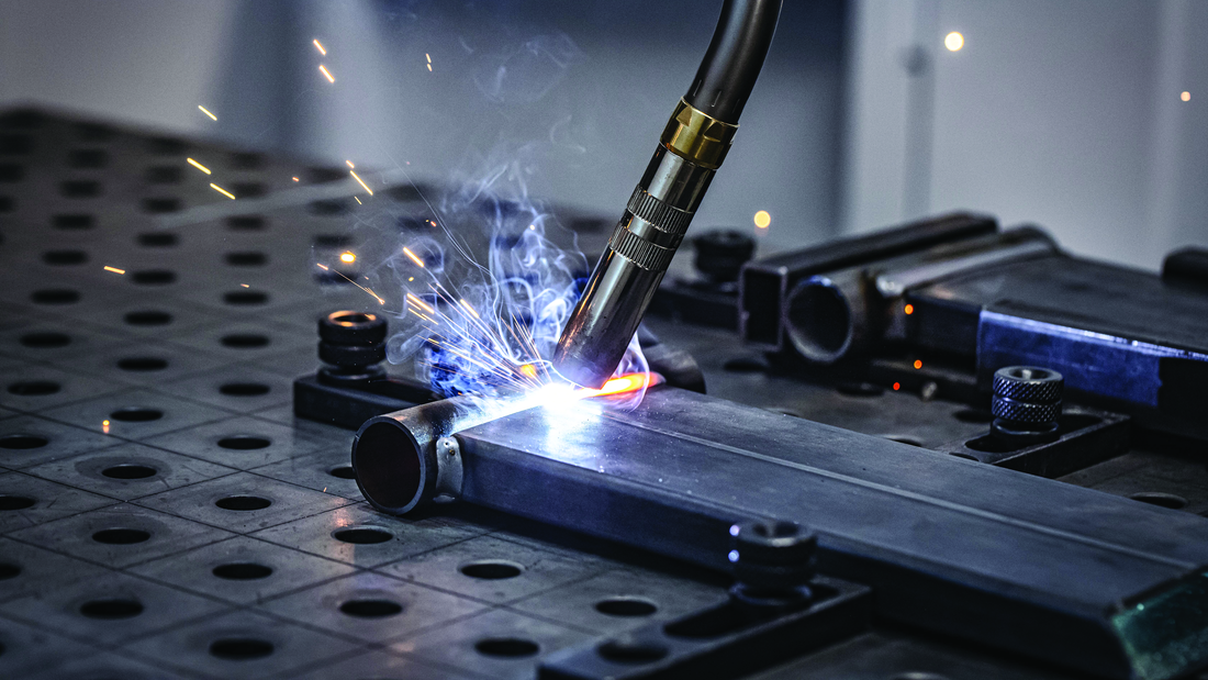

Fig. 4 — TRUMPF’s TruArc Weld 1000 welds a round tube to square tubing.
