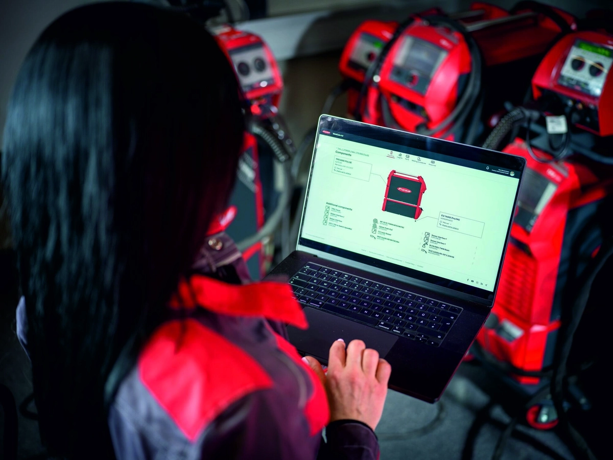

Today, welding operators can connect digitally to verify machine settings and monitor weld data. In the future, AI will help them predict issues, adapt to changing conditions, and optimize each weld in real time.
