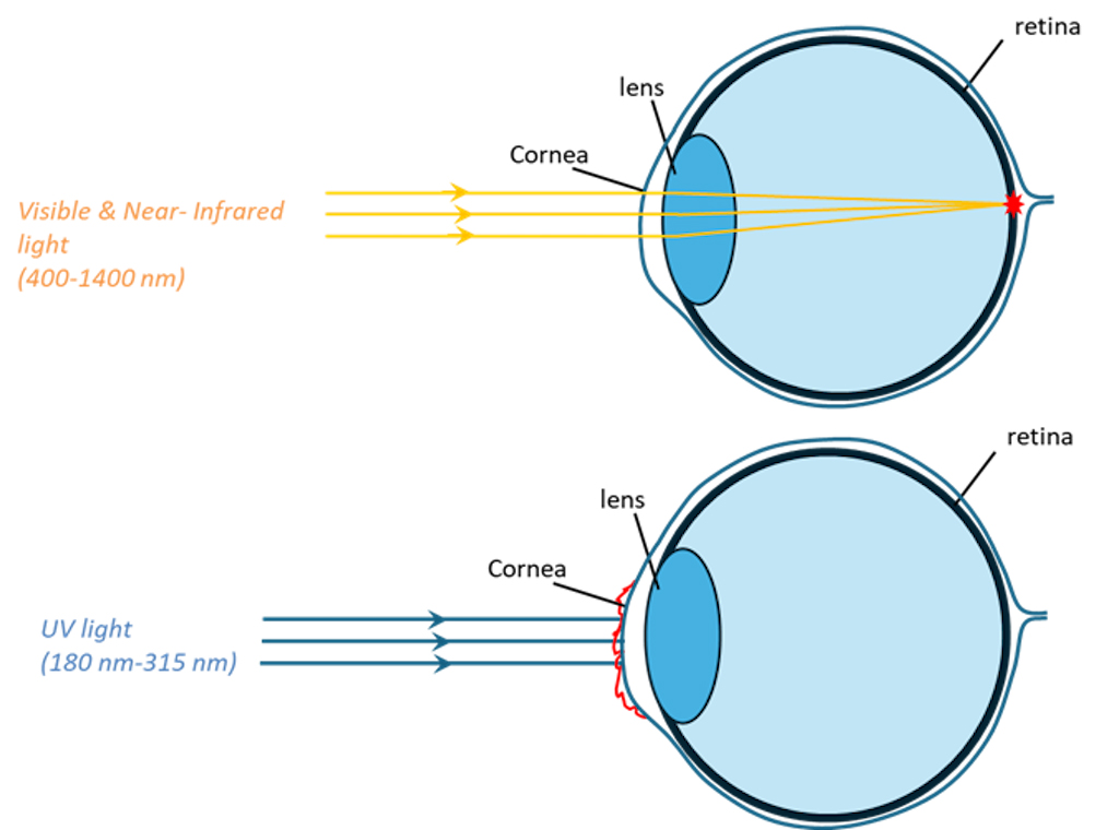

Most handheld lasers on the market are fiber lasers, which produce wavelengths near 1070 nm. This wavelength is in the infrared spectrum and is invisible to the human eye. It won’t trigger the human corneal reflex. Humans may not notice the immediate damage to their vision if exposed to laser energy without proper protection.
Figure 1 shows a simplified human eye diagram, including the cornea, lens, and retina. If proper personal protection equipment (PPE) is not utilized, the visible and invisible laser light will pass through the cornea and be focused by the lens onto the retina. The invisible laser light can permanently damage the retina. The cornea will absorb UV light and can cause temporary symptoms.
WD May 2025 - Safe Environment Fig 1
Figure 1 — Human eye diagram with different light wavelengths.

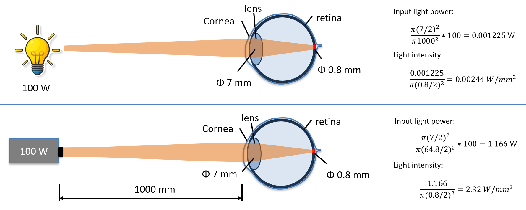

An example calculation of laser intensity on the retina is made to better understand the laser energy level compared to visible light. Figure 2 shows the light intensity on the retina of a light bulb and a fiber laser with a beam divergence of 32.4 mrad at 100 W from 1 m away. The light intensity on the retina of a fiber laser is 952 times that of a light bulb. Scaling this model up for a 2-kW handheld laser, the light intensity is almost 20,000 times that of a 100-W light bulb. Even at significant distances, invisible energy can pose a hazard to individuals who are not properly protected.
WD May 2025 - Safe Environment Fig 2
Figure 2 — Light intensity comparison between a light bulb and laser.
