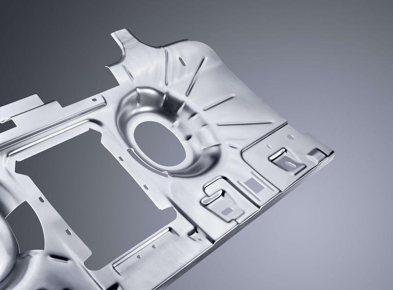

Without the use of lasers, it would be a struggle to put vehicles together in a safe and efficient manner today. From welding fan wheels to laser marking control panels, lasers are part of the entire car-making process. One of the most used applications for lasers within the automotive world, however, is cutting. Laser cutting, specifically multiaxis laser cutting, is what ultimately shapes your car and keeps it safe and secure (Fig. 1).

First, to protect against corrosion and other types of deterioration, several parts of a vehicle are often produced from galvanized steel, such as the body of a car. When utilizing a laser system with multiaxis cutting capabilities, you can cut these galvanized steel sheets very quickly while maintaining extremely high quality. For those who deal with a lot of prototype construction or preseries production, a multiaxis laser cutting system also allows them to react in a fast manner to any changes that need to be made and, thus, adjust the component appropriately.

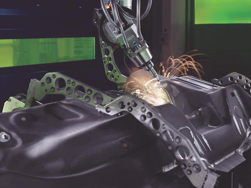

We next examine the door. How was that door created for your car? Most likely with the help of a multi-axis laser cutting system. Using laser technology, you can very quickly and easily cut large dimensions of a hot-formed vehicle section, all while producing high-quality results.
Multiaxis laser cutting systems are not just used for the body, doors, and other large parts but are also used to create many of the smaller and more detailed portions of a vehicle. With a laser cutting option, you can easily create the openings and trimming of the vehicle rear seat (Fig. 2). Trying to perform this process with conventional punching tools, especially for small quantities, is often very expensive. With the use of a multiaxis laser cutting system, you can cut all the required contours on these components extremely quickly, ultimately reducing production costs.
But what about those complex components within a car? The use of a multiaxis laser cutting system is a more cost-effective solution compared to alternative processes, such as milling. The laser system can cut all the outer contours and creates the through holes, making it capable of tackling even the most complex parts.
