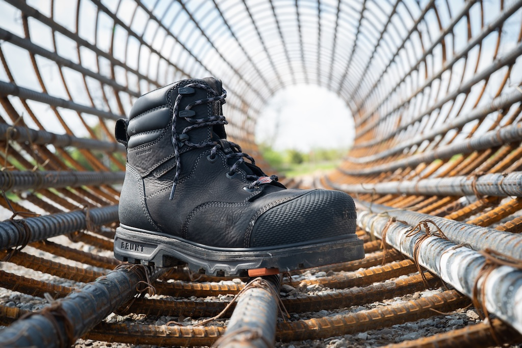

It’s ideal to invest in boots that are EH rated and waterproof, have Goodyear welt construction, offer a slip- and oil-resistant outsole, and feature a round safety toe with a protective cap.
