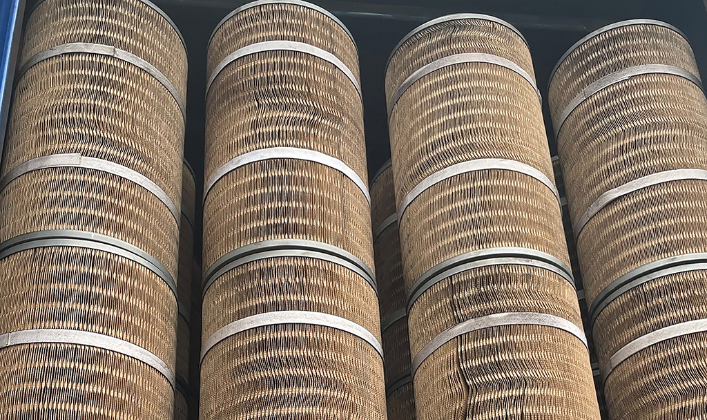

Change cartridge filters when they become loaded or show signs of wear or damage.

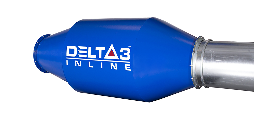

A centrifugal spark arrestor keeps sparks from entering the dust collection system.
-If your operations generate a large number of sparks, a centrifugal system may provide more safety.

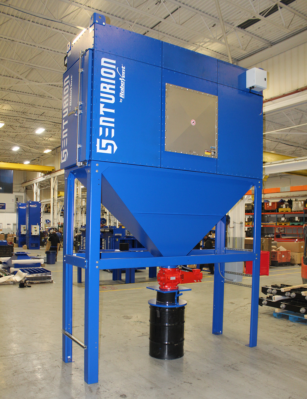

The explosion vent (silver) safely releases excess pressure. The rotary airlock (red) prevents dust from the collection bin from escaping backward to fuel an explosion.

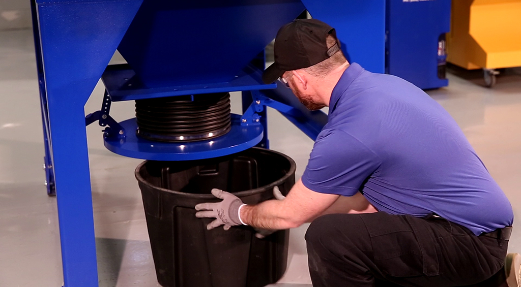

Change bins or dust trays regularly to prevent overfilling.
