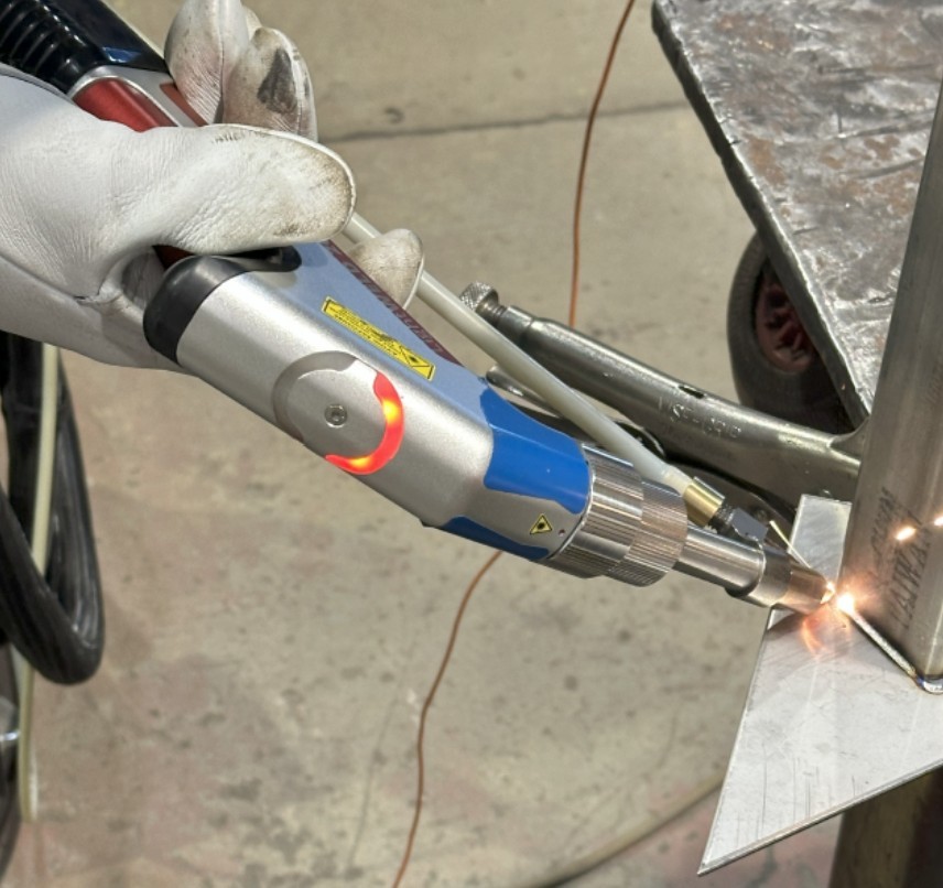

How Does Laser Welding Work?
Laser welding relies on a focused beam—delivered via fiber optics or mirrors—to melt material at the joint. The result is a narrow, deep weld with a small heat-affected zone and minimal thermal distortion.
Shielding gas, typically argon or helium, is used to prevent oxidation. The process can be automated through CNC or robotic systems, making it ideal for high-precision or high-volume applications. It's commonly used on metals like stainless steel, aluminum, titanium, and even dissimilar metals.
