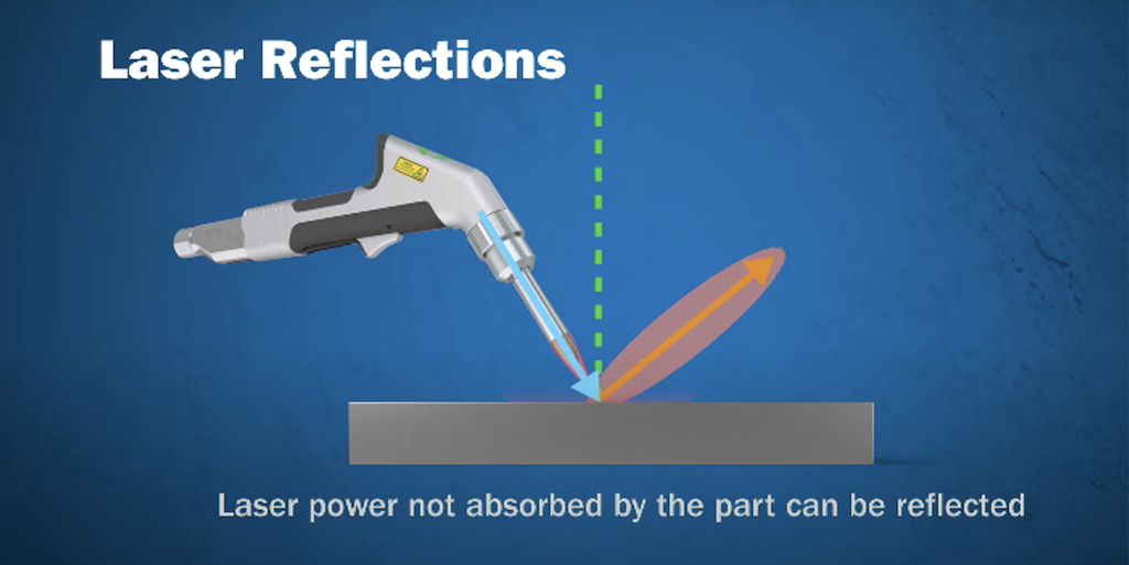

Highly reflective metals can produce hazardous reflected beams by “specular” (mirror-like) — Fig. 1. The intensity of the reflection will vary based on the material type and surface finish. Also, very thermally conductive metals (e.g., aluminum and copper) can cause some portion of the laser beam energy to be reflected from the target weld site since the plasma ignition is delayed (Fig. 1). Once the plasma is initiated, specular reflection is minimized. The user needs to assess the work site prior to using the hand-held laser welding equipment to understand the surfaces where hazardous reflected beams can exist. This assessment shall include a complete review of the LCA.
Fig. 1 — Laser power not absorbed by the part can be reflected.

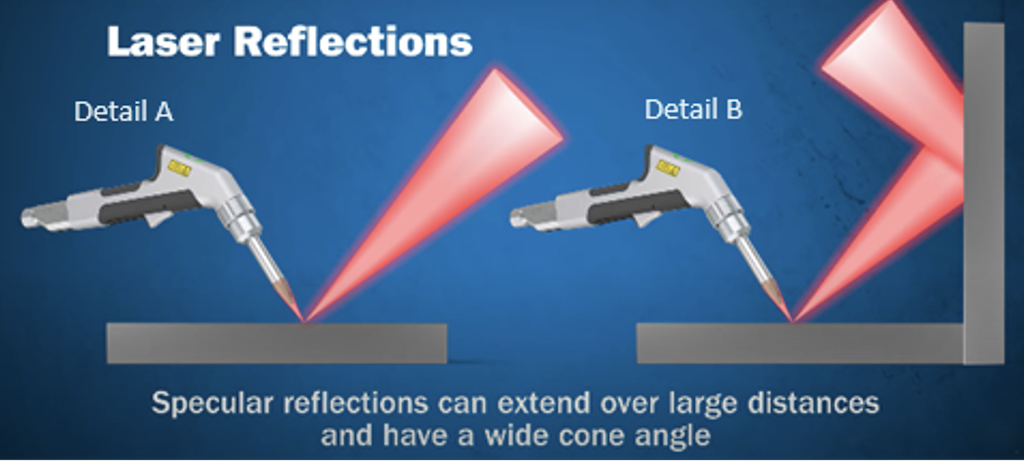

The normal direction of the laser reflection from a metal surface can produce a hazardous beam reflected from one surface of the targeted weld site — Fig. 2, Detail A.
Additionally, the normal direction of the laser reflection can produce a hazardous beam reflected back from two surfaces oriented at an angle (termed a “retroreflection”) — Fig. 2, Detail B.
Fig. 2 — Specular reflections can extend over large distances and have a wide cone angle.
Specular reflections can present eye and skin hazards to the operator as a portion of the beam can be reflected from multiple surfaces.
