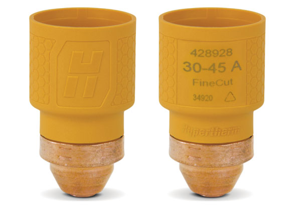

Cutting, gouging, and flush cutting conductive metals such as carbon, stainless steel, and aluminum are relatively straightforward with plasma cutting machines. However, using a plasma cutting machine with features and capabilities suited to the specific application is important. Some units combine the five elements of a traditional plasma cutting machine into a single-piece cartridge consumable. Operators can change out swirl rings, electrodes, nozzles, retaining caps, and shield caps quickly and all at the same time with a one-piece cartridge system, saving time and ensuring reliable performance — Fig. 1. Such cartridge systems also allow operators to quickly change cutting functions by simply changing a cartridge.
Fig. 1 — Plasma operators can opt for single-piece cartridge consumables to save time and ensure performance.

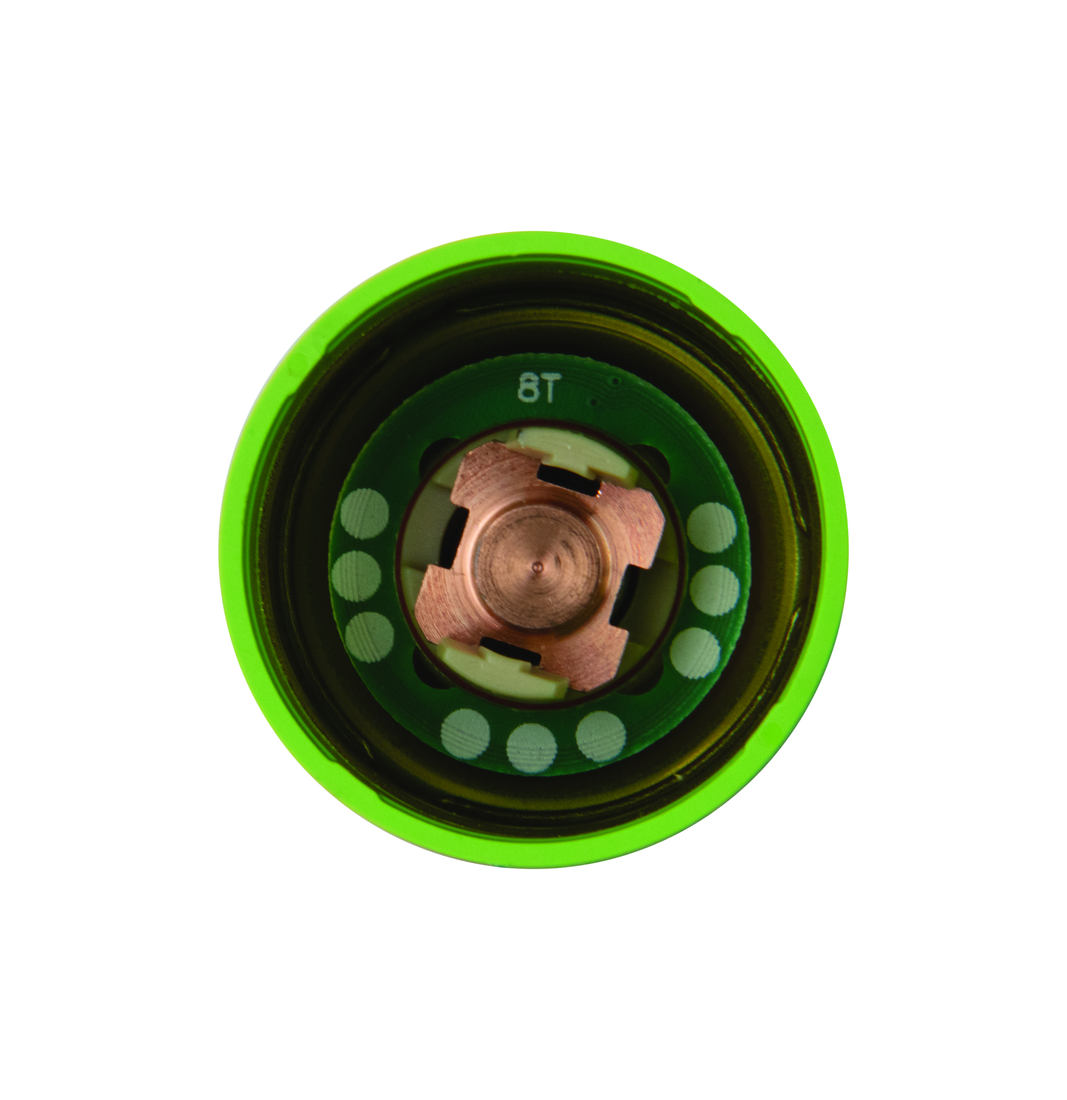

Advanced smart technology is also available that uses RFID chips to collect data on arc starts, use time, and machine performance, helping optimize cutting machine application and maintenance — Fig. 2. Additionally, some equipment manufacturers have designed systems that sync cartridges with machine functions, making them easy to set up and use for a variety of operations. In many cases, with the right system, workers do not necessarily need to be proficient drag cutting and plasma cutting operators. They only need to understand how to change a cartridge.
WJ Dec 24 - Feature 03-Huang-Hypertherm - Fig. 2
Fig. 2 — Smart technology for plasma applications includes RFID data collection to maximize output.
