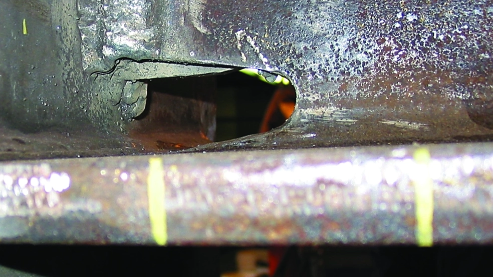

Beam bottom flange and web field welded to column, with AWS D1.8 alternate geometry weld access hole.
