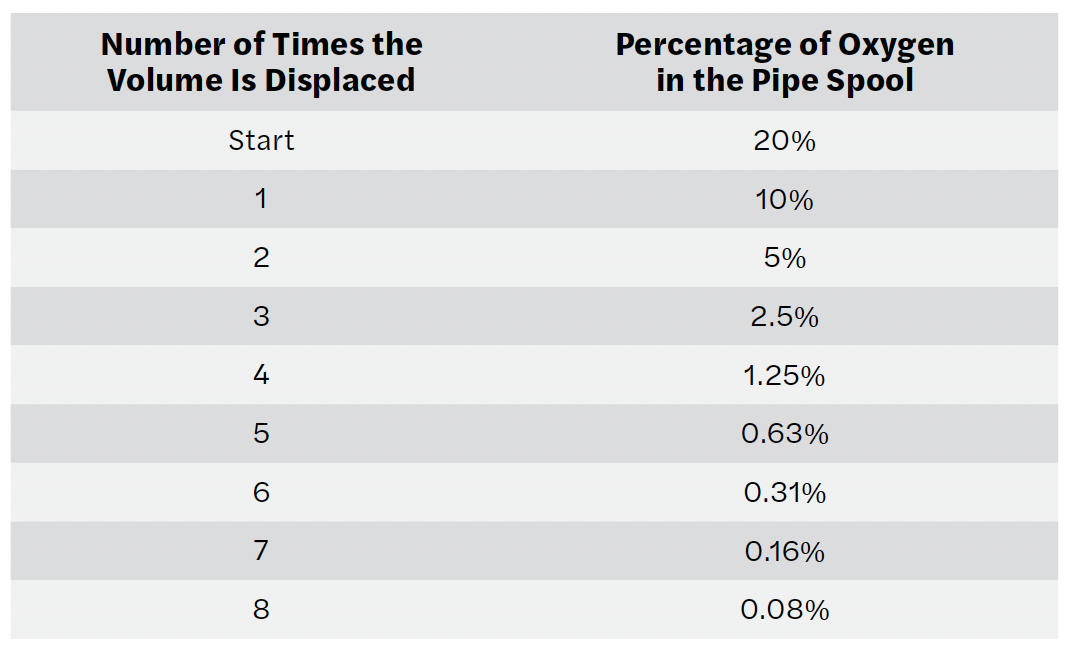

We have to displace the air inside the pipe. Air comprises both nitrogen and oxygen in the proportions of about 80% nitrogen and 20% oxygen. Generally, the open ends of a pipe spool are blocked off with tape or plugs. Enough argon is fed into the pipe to displace the air, reducing the oxygen to a level low enough to prevent oxidation. Argon is heavier (more dense) than air, so the argon settles toward the bottom of the pipe and displaces the air upward. Only if it was this easy. The truth of the matter is that argon and air are going to mix. It has something to do with Charles Dalton and a few other notable men of years gone by who were messing around with gases in their spare time. So, assuming the gases will thoroughly mix, we can estimate how many times we have to displace the air volume in the pipe spool to reduce the oxygen to a tolerable level (see the table below).
Let’s assume there is 20% oxygen inside the pipe spool. We displace the air volume by 1, and the percentage of oxygen is reduced to 10%. Once again, we displace the volume of gas in the pipe spool; the rate of oxygen is 5%. Displace again and oxygen is down to 2.5%; again, 1.25%; again, 0.625%; again, 0.31%; and so on. This assumes complete mixing of the gases with no leakage (because we taped the joints).

To reduce the oxygen to no more than 0.25%, we need to displace the volume of the pipe spool by a factor of 7 times.
7 × 2 = 14 ft3 of argon. At a flow rate of 20 ft3/h, 14/20 = 0.7 hours.
Convert hours to minutes: 0.7 h × 60 min/h = 42 min of purge time.
