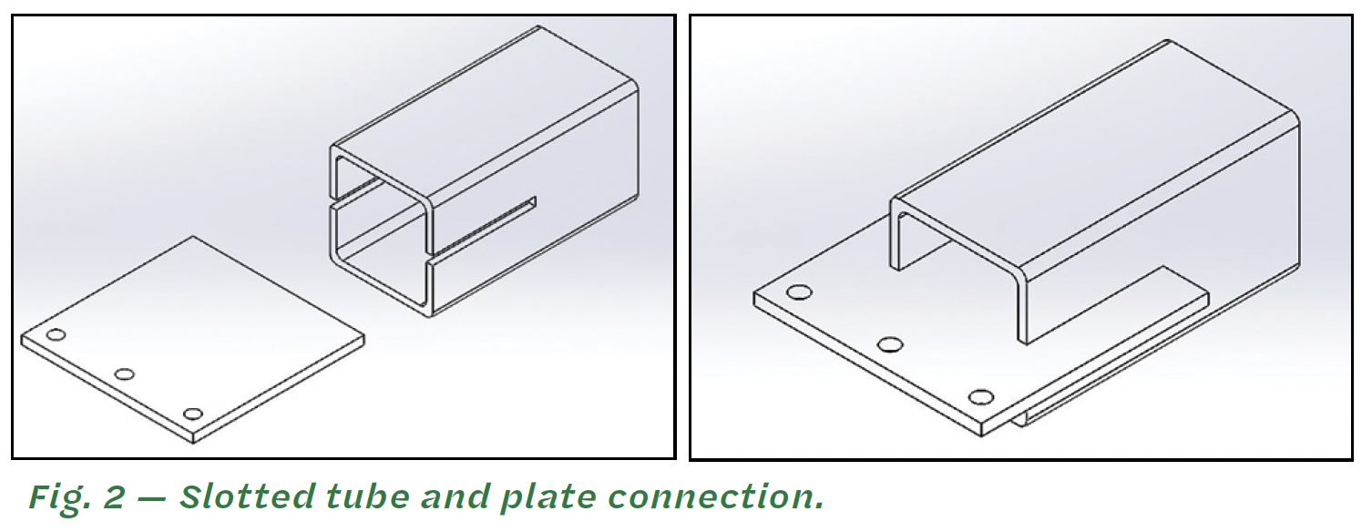

In structural steel design, a common detail is to have a hollow structural steel tube slotted to accept a plate gusset, which is then attached to the larger structure Fig. 2. This slotted tube is typically welded with fillet welds on the exterior of all four areas where the tube wall contacts the gusset plate. When employing symbols to communicate this requirement, it may seem natural to use double fillet weld symbols to indicate a fillet weld is required on each side of the gusset plate. However, this is an incorrect application of the symbol and, if interpreted correctly by the welder, will result in a much different weld configuration than desired (should it even be physically possible to complete).

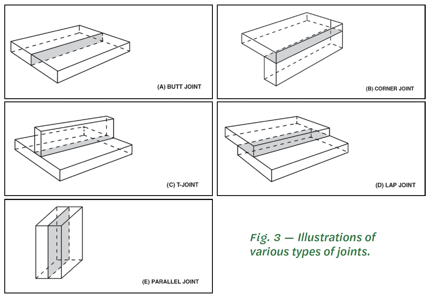

It is emphasized that AWS A2.4 states that information applies to the arrow side and the other side of the joint. To understand exactly what constitutes the joint, we look at the information provided in AWS A3.0M/A3.0:2025, Standard Welding Terms and Definitions. This defines a joint as “the junction of workpiece(s) before and after joining” and further references Figs. B1 and B2; illustrations from A3.0 Fig. B1 are reproduced in Fig. 3.

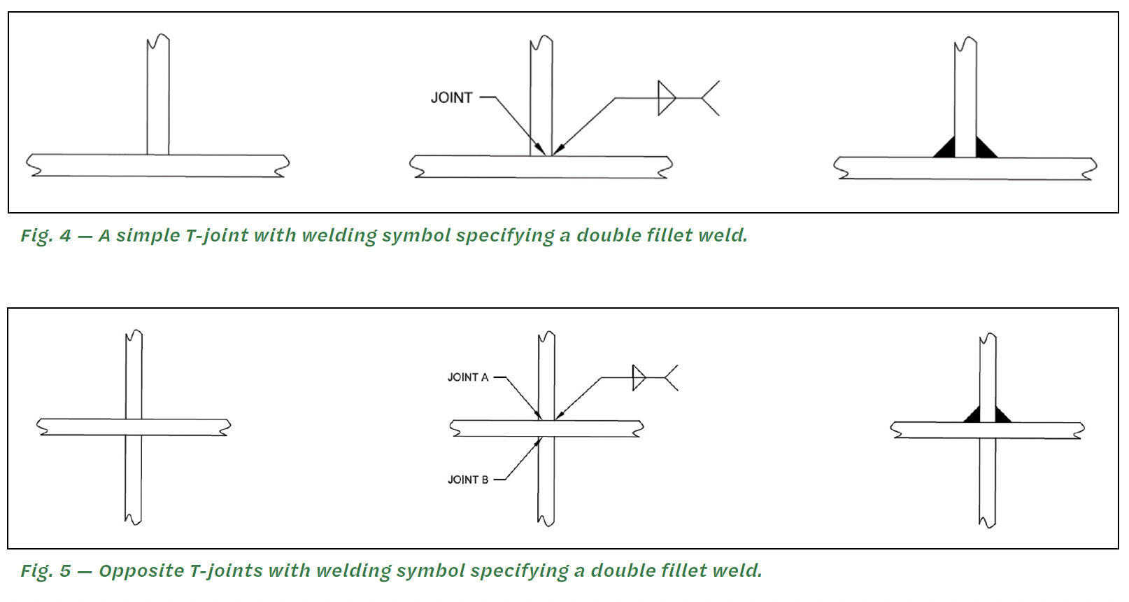

Note that the area defined as the joint is shaded in these figures. In every case, there is a surface of one member of the joint bearing on a surface of the other member and a path from one side of the joint to the other, which includes one surface from each member. When applied to a common T-joint, the location of the joint itself, and thus the applicability of information shown on the welding symbol, is clear Fig. 4.
When a second T-joint is added to the opposite side of the horizontal member (Fig. 5), two distinct joints are created, here designated Joint A and Joint B. The welding symbol, whose arrow points only to Joint A, only applies to Joint A and calls for a fillet weld to be applied to both sides of the joint.

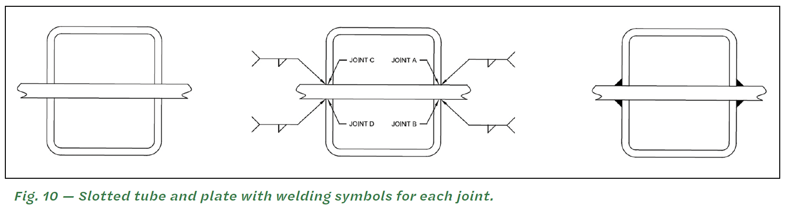

If a weld on the exterior of all four walls of the tube is required, four separate single fillet symbols are used to communicate this Fig. 10. Keep in mind that it may not be necessary to use symbols to indicate every weld required; notes in the tail of the symbol or other drawing notes may also be used to communicate these requirements.
