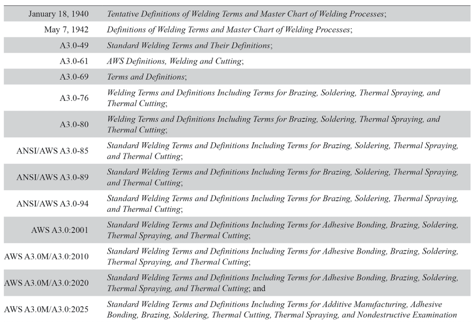

The evolution of AWS A3.0M/A3.0 is shown in the table below:
